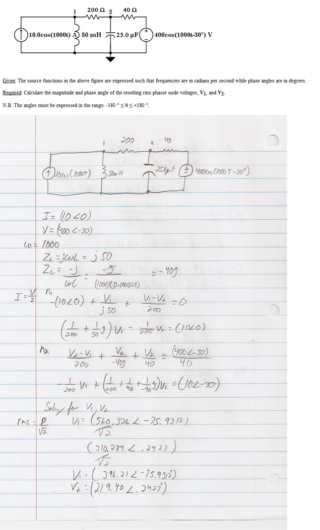

Having some trouble with finding the RMS node voltages. Here is my work and the problem

t_n_k Joined Mar 6, 2009 5,455 May 12, 2010 #2 Everything looks OK up to the final solution of the two equations - although the location of the 'j' operator looks inconclusive at a couple of places in your equations. I have V1 rms=369.73 at phase angle 70.48° V2 rms=178.64 at phase angle -54.7°

G Thread Starter gengm Joined Apr 7, 2010 23 May 13, 2010 #3 Was a calculation error on my part. I got the right answer.
