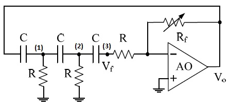

I have to find the minimum required value of Rf for oscillations to start in this circuit. R=1k e C=80nF
I know that for oscillations to start, Vo/Vf has to be over 29. But I can't find that expression.
I wrote these equations:
(V1/R)+(V1-V0)*(sC+1/Rf)+(V1-V2)sC=0
V2/R+(V2-V3)sC+(V2-V1)sC=0
Vf/Rf+(V3-V2)sC=0
Since the ampop is ideal, I admitted that v-=0, so the third resistance is connected to the ground through the virtual short circuit.
What am I doing wrong?
Thank you for your help!
