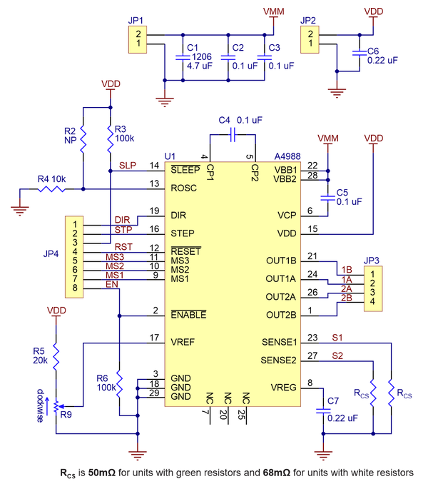

Hi All,
I'm working on a CNC project and am having trouble with 4N25 optocoupler. This circuit works fine if I connect my parallel port directly to the A4988 breakout board, but either doesn't work at all or, if I touch the floating resistor from pin 6 of the 4N25, is very sporadic and jerky. Sorry for the crazy schematic. I'm using an '04 Thinkpad to run EMC2.
Any suggestions for improvements would be greatly appreciated. What is the risk to my parallel port if I just connect the step/dir output directly, without isolation?
