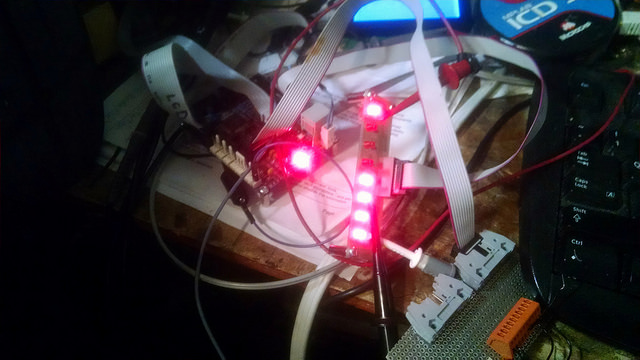

That's an old Japanese DSS5020A (digital but really limited) storage scope looking at a LCD timing signal from this mess on the desk. The well used and abused 2465A (the king of analog) is displaying the SPI clock, data and two debug pulse signals to check for instruction timing in a ISR state machine.
Delay trigger on the clock ch1
I've got the TEK MSO at work that's pretty cool, really nice when decoding serial bus signals.
