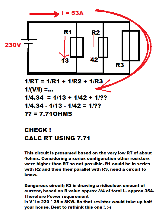

Hi all,
IF R1=13Ω, R2=42Ω R3=???Ω.
V=230Volts & I=53amps.
Calculate R3
Im familiar with using Volts & Amps to get Resistance Total, but not sure with above when given 2 of the 3 resistance values.
Using V & I to calculate I get:
Rt = 4.339622Ω
I thought it would make sense(in my head to) then -R1 & R2 values from Rt to give R3??
Is this correct?? Thx

Hello,
You can take an other approach to the problem.
You know the total current.
You know two resistor values.
With the given voltage and the two given resistors,
you can calculate the currents through these resistors.
You can subtract the calculated currents from the total current.
With this resulting current and the given voltage,
you can calculate the missing resistor value.
Succes,
Bertus

@bertus - Advice noted. , when I said check RT with R3 value, I was hinting for the OP to make some effort there.
There was nothing asked regarding power but I felt it'd be wise to inform someone new that considerations needed to be made.
