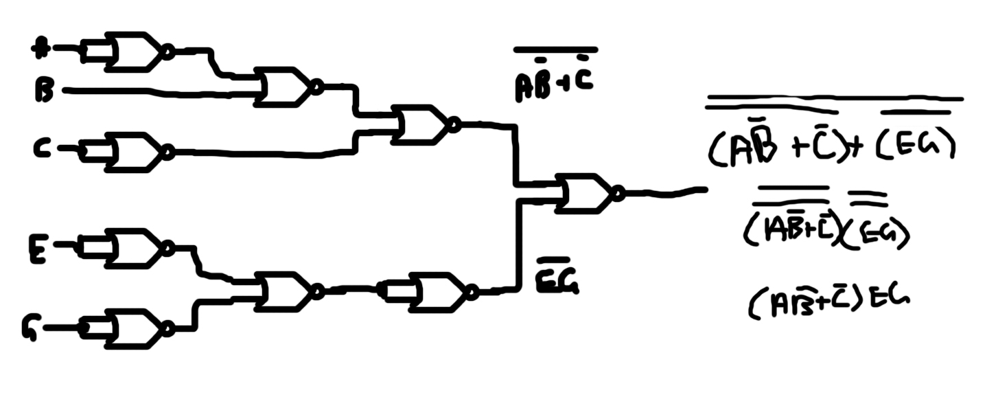

Working along at a very leisurely pace. I have a couple of more questions. First one, when can I cancel the bars? Are there any specific rules regarding this? From trying different things I've come to the conclusion that one can only cancel bars of equal length, are there any other cases?
Secondly, what I come up with first (with NOR gates), generally won't be correct in terms of inversions on the first pass, so I have to go back and re-draw. Obviously practice makes perfect, but is there a trick, or system, perhaps indicators that I can look out for to optimise? It feels like I'm missing something and spending too much time on each layer. Here's my circuit below for (AB'+C')EG:
Is it as optimised as it can be? I would say yes, but I've been known to get ahead of myself.

Why are you trying to base things on "bars of equal length"? It sounds like you are focusing on mechanics and not concepts. The concept you need to be thinking of is the identity that
(A')' = A
Keep in mind that A can be anything, including a function of many variables. When written using overbar notation, the two bars will be exactly matched (i.e., same length over the same thing) and can be canceled.
You diagram looks fine. It's probably as simple as it gets if you are constrained to using 2-input NOR gates. Since you only give the final result and not your step-by-step procedure, there is really no way to comment on whether there is a better way to do it.
