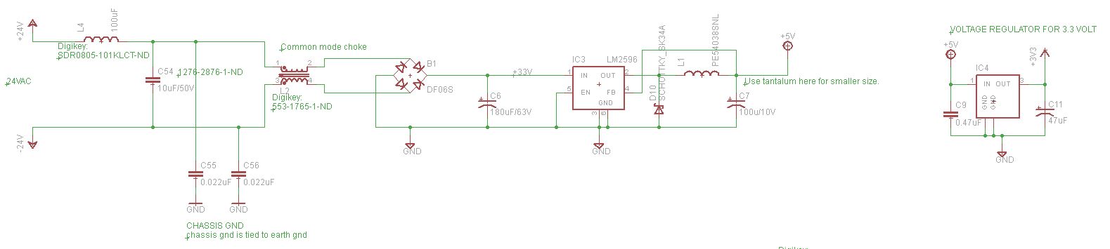

  9. signalflow
    Thread Starter Member
    Mar 12, 2014
    50
    0
    Here is the schematic. L4 and C54 form the LC filter with cutoff of 5KHz. C55 and C56 are the new caps going to chassis (earth) gnd.

  10. signalflow
    Mar 12, 2014
    50
    0
    I disconnected all of my digital inputs (monitoring switches) and disconnected my relay board and the noise stopped getting in as far as I can tell. So the power supply schematic above appears to work. Now I just need to figure out how to filter the noise out of the digital inputs and the relays.
  11. THE_RB
    AAC Fanatic!
    Feb 11, 2008
    5,435
    1,305
    Everything you put between the mains transformer and the bridge rectifier was a complete waste of time and parts. :)
    The mains transformer inductance is so incredibly large you won't get any significant noise coming out the secondary.
