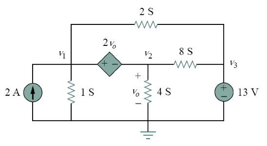

For this question I need to fined V1,V2 and V3 using nodal analysis.
The resister values are in S... which I'm guessing is admittance (my lecturer used Y for admittance in his notes :confused:).
so here is the cct
for the analysis I am unsure as to the voltage between V1 and V2... I'm assuming its just 2Vo.
I'm realy not sure if I constructed my equations correctly...
here is what I have for my equations.
s = 1/R
At node V1
eq1) 2(V1 -V2) +2 + 2Vo = 0
at node V2
eq2) 4V2 -2Vo + 8(V2 - V3) = 0
node 3 = 13V
Vo = 1(V2)
substituting V3 = 13 and Vo = V2
eq1) 2(V1 - 13) + 2 + V1 + 2V2 = 0
3*V1 + 2*V2 = 24
eq2) 4*V2 + 8*V2 - 8*V3 - 2*V2 = 0
10*V2 = 8*13
V2 = 10.4V
subbing V2 into eq1
V1 = 1.1V
Thanks guys :)

Unfortunately your equations are not correct.
You seem to be treating the voltage controlled voltage source as a current source.
Keep in mind that V2=Vo.
So it's worth noting that V1=V2+2Vo=3Vo
I would combine Node 2 (LHS of equation) & Node 1 (RHS of equation) as
8(V3-V2)-4V2=V1+2(V1-V3)-2
Then substitute V1=3Vo, V2=Vo & V3=13 and solve for Vo

Your answers check out.
I would give some attention to Jony130's post.
You will need to understand how to deal with supernodes as they crop up from time to time in circuit analysis problems - so it would be worth doing some reading on that topic.
