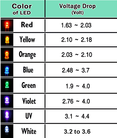

I am trying to hook up a simple circuit for a prop. I need to illuminate 3 LEDs and have them each wired so they can be turned off individually (in this case cut).
I have at my disposal:
Multicolored LEDs (red, yellow, green, etc.) With no voltage or amperage information.
Resistor multi-pack
Wires
9V battery snap on adapter
2x AA adapter
4x AA adapter
Multimeter
I have read a bit on the topic. If possible I want to have each light 'cuttable' without affecting the rest of the lights. I understand this might not be possible with one power source. I know a series would likely need to be used so they don't all go out when one is cut, but the amperage would change as some are removed, and I'm not sure if LEDs can work with those fluctuatuons.
My biggest issue at the moment is I have the LEDs without any information. Can I measure them somehow using the multimeter to get the V and A required? I have some idea how to identify the resistors and there amounts (or read them off the meter) but I can't find the right resistor without knowing the LED specs.
I imagine I would have the positive lead off the battery going to the 3 resistors which are connected to the LEDs long leg (cathode?) And then the short legs would link back to the negative terminal on the battery.
Any help would be fantastic, I can provide more information if needed. Thanks!

Okay, thanks for the chart. If one of the lights is disconnected, it won't affect the other lights (in terms of V or A?) And they will go on working fine? If I am powering more lights do I need more battery power?
mcgyvr
Joined Oct 15, 2009
5,394
No.. removing one won't effect the others as each is in parallel with the other and essentially its own circuit..
battery power will dictate how long it runs before the LEDs dim/go out..
Battery voltage dictates how many you could put in series (not parallel)
The power source needs to be greater than the sum of the forward voltage rating of the LEDs in each series string..
So (examples)
If the battery voltage is 3Volts and the LED has a Vf of 2.2V then you can only have 1 LED in series.. as 2.2 < 3 but 4.4 (2 LEDs in series) is > 3
If battery voltage is 6V then you could have 2 LEDs in series as 4.4 < 6 but 6.6 (3 LEDs in series) is > 6
If you had 10 LEDs in series (10 x 2.2 = 22) you would need a supply voltage of greater than 22 V
make sense?

Yes, that's helpful! I am going with green yellow and red. I have 3mm and 5mm, and am assuming the 3mm take less voltage. So if I have 3 3mm I could get away with a 9V? I am assuming once I add 4 the voltage isnt sufficient and they turn off? If there's too much voltage does it just draw what's needed, or does it fry if there's too much? Also, in parallel, how do I find out which resistor to use with each LED?
pcaston2
Joined Dec 17, 2015
8
Size of led doesnt dictate its Vf.
Okay. Well I'm assuming the reds are 1.7 and yellow/green are 2.2
Wanting 20 mA I took 9 away from 1.7 and 2.2 respectively and divided that by 0.02
The result was 365 and 340 ohms respectively. Would that do the trick (assuming the LEDs are close to right)?
No.. You are thinking about typical resistive loads (sort of) which LEDs are not ..
A regular resistive load that (for example) requires 12V at 1 Amp can be powered with a constant voltage power supply of greater than 1 Amp.. It will only draw the current it needs.
With an LED you power it with a voltage greater than the sum of the Vf and you use a resistor to "set" the current of that circuit..
In general, the forward voltage is the minimum voltage required to cause the LED to start "passing" electricity through it.. Not enough voltage and that led door is just shut and no current is flowing in that circuit..
