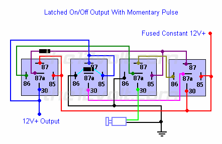

Supposedly this circuit will do it:
But I hate relays because they are noisy, expensive, and large. I'd be happy to consider this option if I can have a silent relay that takes up less than approx. 1/2"x1/4" of PC boardspace (preferrably much less). I don't have any of those in my project box though...

I would recommend using a small reed switch or relay connected to your existing push button and the reed is small and virtually noiseless in operation.
