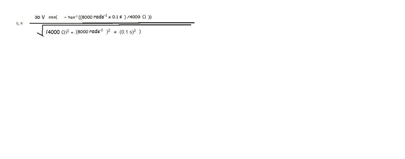

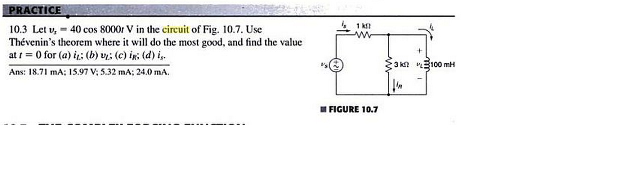

nishu_r
Joined Jun 2, 2012
31
A good hint you gave there, as far as circuits is concerned reasoning is as important as applying formulae and the maths that comes with it.
And i just meant that even mathematically we can see the difference since the natural freq takes in resonant freq as a part in it's equation(omega_d=(sqrt)(omega_0^2 - alpha^2) for an underdamped response), so the relation is mathematical to see. And yes it is real.
And sir I don't quite understand where i am going wrong in this question i will post now, i did find the thevinin's equivalent and then used the formula to find the i_L(t) for an RL circuit (only the steady state) but my result isn't even close . I am posting it below.
Thanks

Please post a summary of your work, as well. What were your results? What was your Thevinen circuit? What order did you get your results in? These are all very useful and important to figuring out where you've gone astray.
nishu_r
Joined Jun 2, 2012
31
I have posted the image above which shows the thevinin's equivalent circuit that i obtained, and i got an answer of i_L= 7.35 mA . pls let me know my mistakes.
Thanks again Sir, since i am studying on my own i have troubles understanding completely. You seem to be my only hope.
WBahn
Joined Mar 31, 2012
30,082
In calculating the equivalent resistance, keep in mind the definition on series and parallel elements. If two elements are in series, then any electron that flows through one of them has to flow through the other. If two elements are in parallel, then any voltage that appears across one of them must also appear across the other. If neither of these apply, then they are neither series nor parallel.
Also, you didn't track units when you plugged values into your equation.
It admittedly makes it tough when the author is sloppy with units -- and most of them are. For instance, when he has v(t) = 40cos(8000t) V, at least he has the units on the overall quantity (and many authors would leave it off), but he also needs units on the 8000. There are two reasons for this: (1) The value of t could be expressed in one of any of a huge number of units, such as seconds, microseconds, hours, fortnights; (2) the argument to any transcendental function (trig functions, logs, etc.) must be dimensionless. This means that the units used to express t must have recipricol units to whatever the 8000 has. But if 8000 truly has no units, then we have to use a quantity of time that has not units and while I have no idea what those units might be, it can't be seconds. The units of 8000 should be 1/s or, more usefully, rad/s (radians are dimensiohless). When ever you start a problem, examine the units and, if necessary, supply them where the author has been too lazy to do their own work properly.
nishu_r
Joined Jun 2, 2012
31
Yes Sir, but if we were to attach a forcing function to the dead network with the open circuit across the inductor, the electron has to flow through both , so doesn't it make it series? I did come across an instance of two resistors neither parallel nor series with each other, but that was in a larger circuit and was solveable.
I have included the units and i end up achieving Volt/Ohm, which acc to Ohm's law is Amp. And 8000 is rad per sec, Sir i came across another problem in this book, the frequency is in radians but the angle between the voltage and current ,say phi is in degrees. So doesn't it mean i have to convert the degree to radians and then solve ? I was saved because i kept a track of the units , thanks again to you. But with this particular problem, the result i have obtained is largely varying with the answer given i.e 18.71 mA .
WBahn
Joined Mar 31, 2012
30,082
Would it. Imagine applying a battery across the terminals you are looking into (the terminals where the inductor use to be). Does an electron leaving one terminal of the battery have to flow through both resistors to get back to the battery? It seems to me that it has to flow through one or the other, but not both. Also, if you apply, say, 1V to those terminals, what is the votlage across each resistor? If they are in series, then you would have to have a voltage divider.
I have included the units and i end up achieving Volt/Ohm, which acc to Ohm's law is Amp. And 8000 is rad per sec, Sir i came across another problem in this book, the frequency is in radians but the angle between the voltage and current ,say phi is in degrees. So doesn't it mean i have to convert the degree to radians and then solve ? I was saved because i kept a track of the units.
Good. It only takes a few times of seeing that tracking units can save your bacon for it to become an engrained habit. Until then, it is hard to view it as little more than a needless burden (at least emotionally).
Note that, in your equation, it is showing up as rads^-1. I'm sure you meant that to be rad*s^-1 and that this is purely a typesetting artifact. I just wanted to make sure you were aware of it so that you can play with it and figure out how to get it to display the way you want it to.
Worse, you still aren't actually checking your units. Look at the argument of your inverse tangent function. Is that dimensionless? Your 'seconds' cancel out in the numerator, leaving you with 'ohms' in the denominator. Inductance has units of Henries. Using V = L di/dt, this means that 'Henries' has units of (V dt/di), or Vs/A or Ωs. Then look at the denominator. The units of the first term in the radical are 'ohms-squared' but the units of the second term are dimensionless because the 'seconds' cancel. So you are adding two terms that don't have the same units. Can't do that.
nishu_r
Joined Jun 2, 2012
31
But sir, looking into the dead network, how can we work our assumption, and i was meaning before we make the voltage source ,V_s=0(short circuit) and after we open circuit the inductor, then is it a series connection?
Yes i did mean rad*s^-1, it is quite hard working with paint to bring the image of my work which is in a paper.
Sorry sir, but i do understand what unit i will have after tan inverse of ohm inverse, will the tan inverse produce degrees ? i think radians, but correct me. or values inside tan inverse function are just dimensionless?
And sir where am i wrong? apart from this that denies me the answer?
nishu_r
Joined Jun 2, 2012
31
