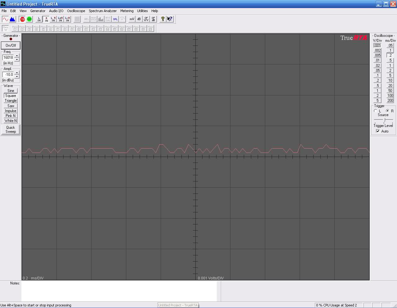

    And it kind of works. However it doesn't appear to be a square wave and it doesn't appear to be oscillating at 80,000Hz at all (to make it 40KHz via %50 duty cycle).
    here's the screen shot from the pc oscilloscope:
    [​IMG]
    Any ideas?

  6. StayatHomeElectronics
    Well-Known Member
    Sep 25, 2008
    864
    40
    The output looks more like noise than anything else. Given that you want a output frequency of 40 kHz, period of 1/40000 is 0.025 ms, you may wish to reduce the ms/div to the lowest setting.
    Do you know what the bandwidth is of the pc oscilloscope? Remember you need at least twice the bandwidth of the signal you are trying to measure, and that doesn't give a very nice visual representation. It is always nice to have five or ten times the bandwidth on the oscope especially when you are trying to see square waves.

  8. kris_maher
    Thread Starter Active Member
    Apr 24, 2009
    90
    0
    [​IMG]
    It's 96KHz. It can also output at 96KHz sampling frequency.
    Oh btw it is on 'OCR1A = 100/2'. That 50 was a typo when I was copying the code from my laptop to my desktop machine that has net access.
    Would Fast PWM have much difference? And does the code seem correct to you guys? Since I've been playing around with PWM/Timers and timers seem much easier to work with than PWM's more advanced settings...

  9. eblc1388
    Senior Member
    Nov 28, 2008
    1,542
    102
    OK.
    Please check your AVR output again with a real instrument like CRO or frequency counter and report back the result.
    The output could be already at 40KHz right now, one never knows unless a proper instrument indicates otherwise.
    Incidentally, you can also use mode=8 with TOP value in ICR1 but you will need to setup the output correctly by setting COM1A1 to HIGH or both COM1A0 and COM1A1 to high instead of just COM1A0 to high.
