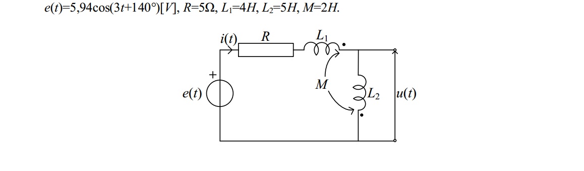

    Is it possible to simulate magnetically coupled circuits using Multisim?
    For example, can I simulate circuit below?

    Look for coupled coils and then place the coefficient of coupling as a constant.

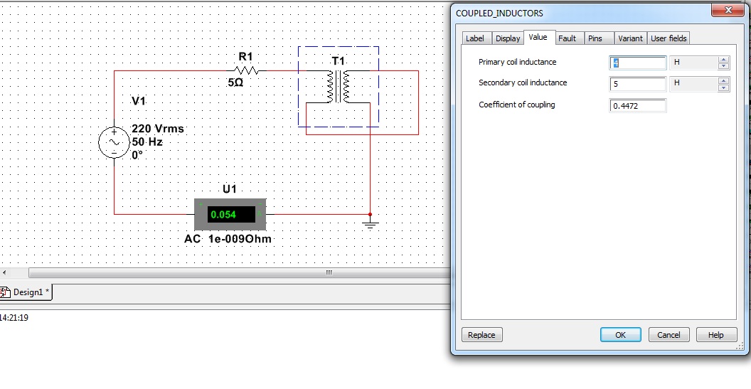

    Something like this?
    [​IMG]
    I found coefficient of coupling using formula k=M/sqrt(L1*L2).

    What is the purpose of U1 in your circuit? I don't think ohmmeters should be placed in "series" with the voltage source.

    U1 is ammeter, my task is to find current in circuit using multisim, I didn't mention it at beginning...

    I made mistake in my first post, instead of "e(t)=5.94*cos(3*t+140)" it should be "e(t)=220*sqrt(2)*sin(314t)".

    Did your calculations agree with the simulator's value? What about the output voltage in your diagram?

    Yes, they agree. I really don't know why u(t) is indicated but it doesn't matter. I also simulated few other circuits and results I got by hand matched with results I got using multisim so I think I got it... Thanks a lot for help!
