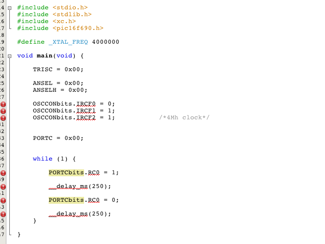

I spoke too soon. After shutting down MPLab and then a bit later deciding to do a bit more work on it, I opened up my project file and the stupid red underlines were back, not just under the __delay_ms, but also under RC0, where I have the statement: PORTCbits.RC0 = 1
I haven't changed anything, so why is MPLab X behaving like this? I also noticed that if I type PORTCbits. sometimes it had a drop down list containing RC0, RC1 etc. but this isn't there now either. What is going on?

Hi The_RB. I just loaded MPLab again this morning and the red underlines under RC0 are gone and also the ones on the OSCCONbits.IRCF0 etc.
Also, when I type OSCCONbits. a drop down appears with the various options in that particular register, like you would expect.
I really don't understand why sometimes the compiler recognises the endings, sometimes it doesn't. But as I said before, it does compile even if the red underline is there.
Oh, I still have the red underline under __delay_ms, I haven't found any soultion for that yet.

Check the help file language reference for "functions" and find the delay functions. The function names should all be shown along with examples.
You may need to change __delay_ms() to delay_ms() or something as simple as that.
From what I've read MPLAB X still has issues such as this. I'm finally using it for the first time and beyond issues (now resolved) with it seeing PICkits I've not had these issues.
The real test for code is if the code compiles. If so, ignore the auto hint stuff.
The built in delay functions for XC8 are described in Appendix A of the "MPLAB XC8 C Compiler User’s Guide" which is on your hard drive; it installs along with and along side XC8.

Cheers ErnieM. The code does compile correctly and works, so I'll just ignore the red underline.
