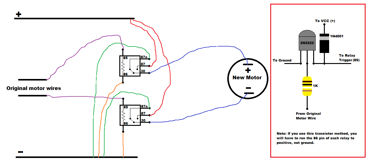

    I am working on a project that requires me to add more voltage and current to my servos. I NEED to use the servos that I currently have but need to replace the servo motor with a larger more powerful servo motor. Does anyone know if I can take the two wires that are connected to the servo motor and connect them to some type of voltage/current regulator to power my larger servo motor?
    Not sure if its a voltage regulator or current regulator that I need but I have already measured the voltage that comes from those two wires and its -6v-0-6v depending on the direction and speed of the servo. I would need to increase that voltage for my larger servo motor.
    So if the signal voltage from those wires was -6 the regulator would supply -12v, if the signal voltage was 0v the regulator would provide 0v, and if the signal voltage was 6v the regulator would supply 12v and so on.
    Any suggestions?
    Thanks!

    Ok, you want to interpose a servo amplifier between the existing motor and a larger replacement motor?
    This should work, with one caution; depending on what type of feedback system there is, i.e. if it's a closed loop system, the new driver and motor could upset the stability of the control system, causing oscillations, etc.
    The change might give the system more / less 'gain' than it's designed / tuned for.

    How important is super fast reaction time? You could run 2 relays that are triggered off of the the 2 wires that went to the original motor...
    [​IMG]
    Not sure what servo you are using, but if it didn't have enough current to drive the relay you could use a transistor between the original wires and the relay (I drew how to add that at the right). Obviously you would need to do a transistor for each relay/original motor wire. I think this would work as long as you chose the right relay.

    I just tried a typically automotive relay on my adjustable power supply, and it would only consistently trigger at 6.5V and above (Figures). Thinking maybe something like this:
    http://www.ebay.com/itm/Mini-5V-DC-...715?pt=LH_DefaultDomain_0&hash=item3379f0593b
    But you may have to limit your servo input voltage to 5V instead of 6 to not overpower the relay coil (Although 6V may be just fine, not sure how sensitive they are), You could still run whatever voltage you want on your "New" motor.
    What is your base servo, and what are you powering with the larger motor in the end?
    Edit, this was listed in the description: Coil rated voltage: 3-48VDC. So you should be fine as long as you do not draw more than 10A.

    Thanks for the reply. Will I not need two relays for each servo though? If the relay only triggers 3-48VDC, than my larger motor would only turn one direction with one relay right? I would have to add another relay to make it turn in the opposite direction right?
    Edit, just found this thread
    http://www.largescaleforums.com/showthread.php?t=6983
    Will I need some diodes and filter capacitors if I run two relays? Mind helping with a diagram with the relay setup, diodes, and filter capacitors?

    oops, you did draw the circuit with two relays already, don't know what I was thinking.

    This could probably be done with the appropriate transistors as well I am thinking, but I am leaning on what I know best.

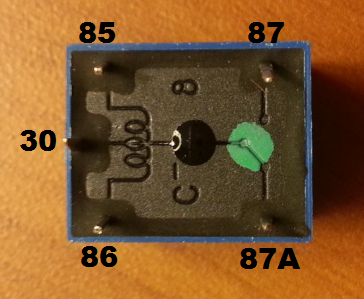

    Received my relays but their a little different than the picture you drew, mind helping me connect them? Thanks!

    What style did you get? Pictures? Diagram on relay case?

    Heres some pictures, going to see if I can find a diagram online

    Use these pinout numbers with my original diagram:
