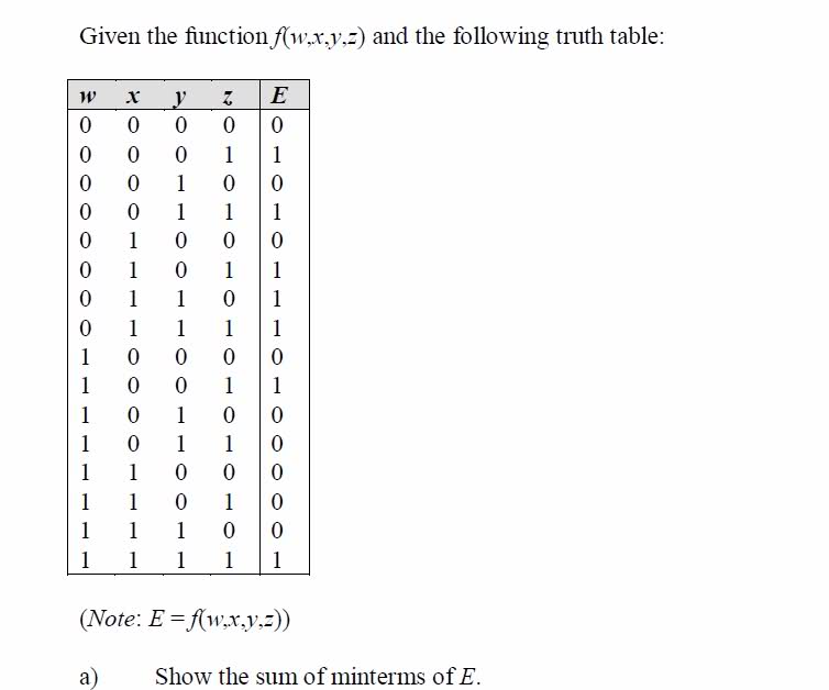

    Hey Guys,
    I have this question for homework and I cant understand part A on how to find the sum of the minterms?
    [​IMG]

  4. Georacer
    Moderator
    Nov 25, 2009
    5,151
    1,266
    So far so good. Keep going.
    I think the question wants you to simplify the above Boolean expression, through a Karnaugh table. If you feel however, that your teacher wants something else, so be it.
