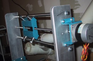

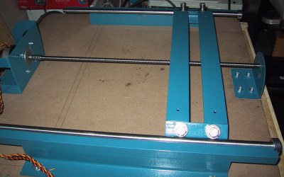

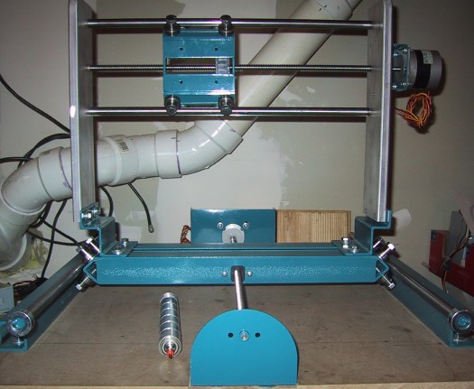

That is why having a good sturdy base and very good bearings for the axis's makes a lot of difference on how much load is on each motor.....
Having the right amount of bearings placed in the right places can aid in reducing the load on each axis, hence reducing the load the motors have to push or pull...
X axis below
Y axis
Both together
X,Y, & Z
With the added weight of the Y & Z axis on top of the X axis, the X Axis motor does not even draw any more current than the other 2 motors when running since all the weight is supported properly on the axis bearings...
