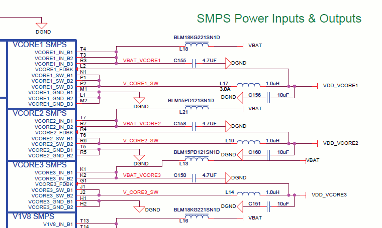

here is part of schematic with this inductor (L18, L13.. etc):
So inductor is connected between Power Manager PMIC (to the left) and OMAP chip (to the right).
Like ErnieM mentioned above, that since I was measuring across inductor, I was measuring voltage related to the change in current (which is probably not what I want).
Should I instead measure from PMIC side across small resistor to ground to get right voltage? (or should it be from OMAP side? Somewhere I read that PMIC side would have a lot of noise..)

Not sure what you mean here, but no matter how well you know the values, the fact is that voltage tells you current through the mathematical operation of integration. This type of relation is a little too complicated and much too sensitive to rely on for a measurement because the present value of current at any time depends on the total past history of the voltage. Also, even if you know the values very well, often you do not know offset voltages and noise sources well at all. I wouldn't say it's impossible, but it is very very difficult and not very robust to do it this way.
A pure resistor or a Hall effect sensor tells you current directly since it is the voltage reading times a scale factor. The value of current now depends only on the voltage reading now. This is so very easy to do.

Ah I see now. Right. I felt doing integration can be hard from sampled data, but I didn't know how accurate it could be.
So with pure resistor.. I would try to measure voltage from it to ground? or how could I bypass inductor and measure its current?
From the schematic above, can I prode it between VBAT_VCORE1 and Ground?
Or will I short it out?
