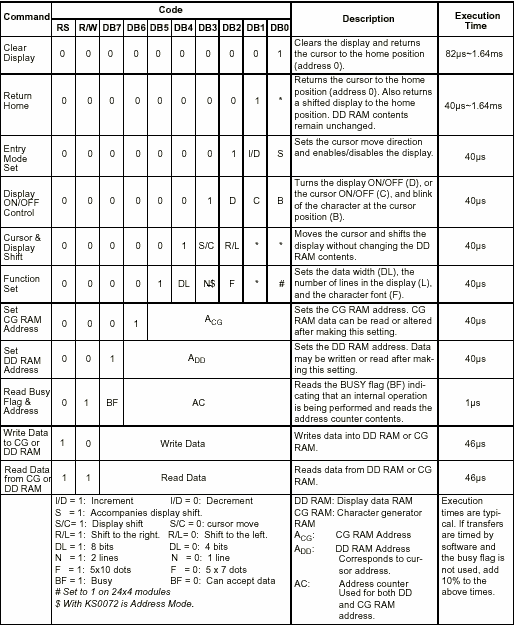

but i tried very well in 4 bit mode but the is some thing wrong as i checked it many times
here is the code
Rich (BB code):

     LCD_write_data(0xff);//'A'
and the result is that the LCD switched on with no data on it
SOS PLZ :D :D
walid el masry
Joined Mar 31, 2009
133
here is the instruction set i written in my code

LCD_write_data(unsigned int output);
     output => Data to be written
and the manual LCD commands
