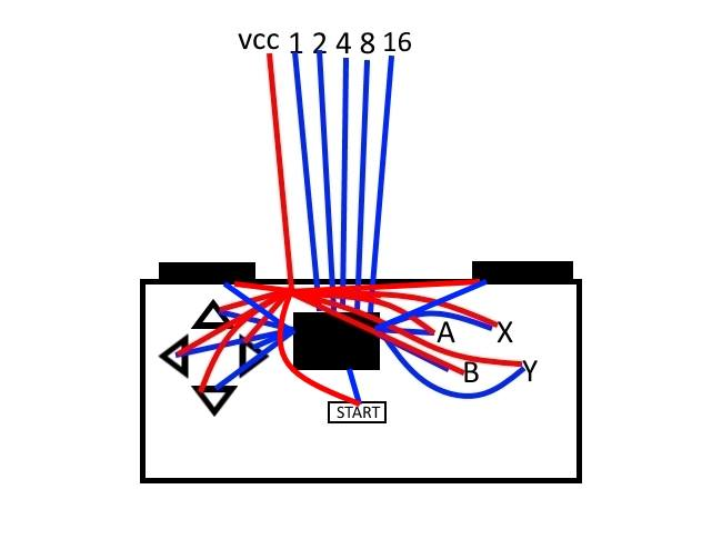

How would one take a single input (e.g. from a button) and make that output a binary code (5 wires for maximum 16 buttons). E.g. button 1 would poll some type of device which would then output the binary signal "1".

It is called a 16-line to 4-bit priority encoder:
There are 8-line to 3-bit priority encoders:
TTL - 74148
CMOS - MC14532
It is just as easy to do with a microcontroller.

Well what im wondering is , say you press button 4, and it's on the 4th input, how would a priority encoder change that into 4 in binary. I'm working with carking on this btw.
So would a microcontroller be the correct way to go in this case?. We'd only be using 5 lines of binary (max 16), because our controllers won't be using 255 buttons :p.
They will be connected to 5 pins in the GPIO, which would be polled by Python, with >20 GPIO pins we could fit 2 controllers with a 5 pin interface easily. This is the only roadblock atm.

Instead of polling 5 pins in GPIO why not have 16 buttons and one serial output line when ever a button is pressed?
(Then you can have as many buttons as you wish.)

11 buttons can be done with either 11 pins or 22 pins.
The output can either be 1 pin or 5 pins. I think 5 pin will be easier to implement, make sure receiver has 5 pins, that way the 1, 2, 4, 8, 16 don't matter because you setup receiver to associate the receiving pin with specific number. Say receiver Pin 1 goes from 0 volts to 5 volts, your software interprets that as 1 was sent. The receiver Pin 2 goes from 0 volts to 5 volts, the software interprets that as 2 was sent. The receiver Pin 3 goes from 0 volts to 5 volts, the software interprets that as 4 was sent.
ErnieM
Joined Apr 24, 2011
8,377
carking1996: If you press one and only one button at a time this is fairly simple to do using just some (33) diodes and some (5) resistors.
OK, that's a lot of parts but the basic idea is simple.
If there is a chance that two or more buttons can be pressed it is a still possible to do using some 74HC148 priority encoder ICs.
Here's one complication or simplification, depending on how you look at it: 15 buttons can be coded into 4 wires as states 1-15 (leaving state zero as "no button"). The 16th button needs another line which gives you another potential 16 buttons to scan, or you can just use the 5th line on the 16 button with no other encoding.

Looks like a game or machine controller. It's almost certain the user will press more than one button at once, so a simple 16line to 4bit encoder (or a diode encoder) won't work.
I like MrChips suggestion of putting a small micro in there and then you just need a serial output wire.
