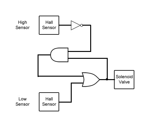

    I'm going to build a device to actuate a solenoid valve when the water level in a tank reaches a set low mark, and then shut off the valve when the tank has filled to a set high mark. I'd like to use hall effect sensors with a magnet in a small bouyant plastic float on the inside of the tank.
    I've come up with this logical diagram. When the water level reaches the low level, the signal into the OR gate will activate the solenoid. At the same time, this will activate the AND gate (because the high sensor has an inverter), with this signal feeding into the OR gate as well. This will latch the activation signal until something happens to turn off the AND gate- which will happen when the high sensor detects the magnet. Here's the logical view I came up with:
    [​IMG]

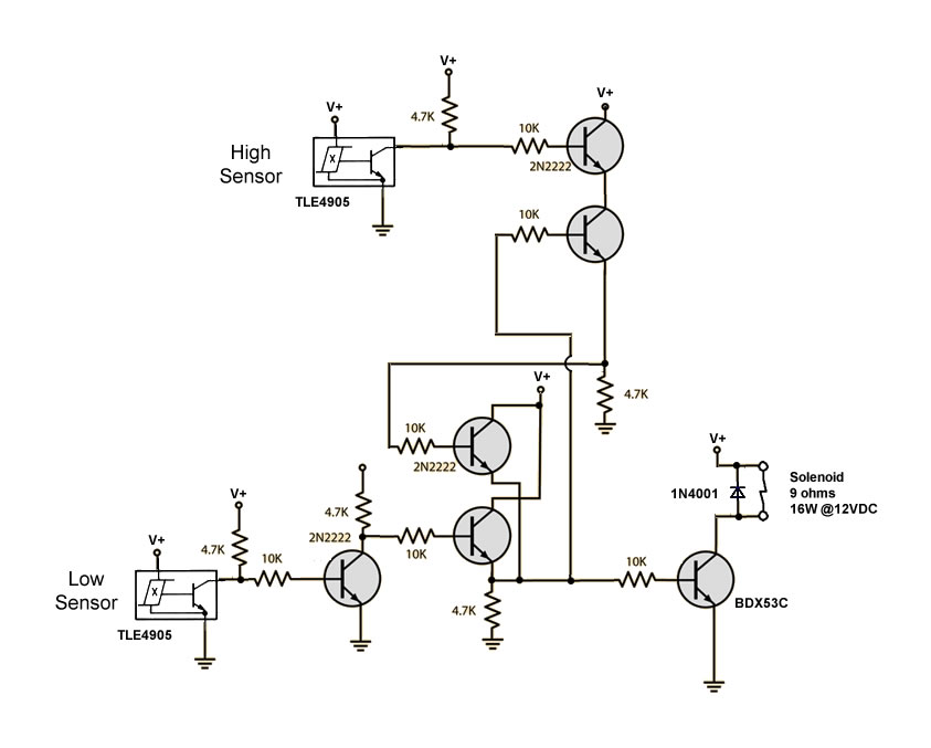

    Since this uses exactly one inverter, one AND and one OR gate it would be kind of wastefull to use 3 discrete ICs to implement this. So I thought I'd implement the gates with NPN transistors instead. Also, it just seemed kind of interesting to do.
    Now, if at any point you begin to think I may not know what I'm talking about, you're most likely correct haha. I'm a software guy but I like tinkering with hardware. But its been many years and I'm a bit rusty even on what I was able to teach myself back then. But thats not going to stop me!
    Anyway, after some research I came up with this implementation. Would love to get critiques before I go breadboard it. In a few circuits I found out there, the designer used diodes between transistor outputs/inputs to protect the transistors, but I don't quite understand why those would be needed or exactly where. So if it looks like voltage swings would damage the transistors and I need diodes to protect that, I'd be interested in learning where. One small change from the logical diagram is that the hall sensor I found has an open collector and from what I gathered reading the spec pulls the output to ground in the presence of magnetic induction. So for this sensor, its actuall the bottom that needs to be inverted. I also added a BDX53C transistor to drive the solenoid.
    Forgot to put this on the diagram, but V+ is 12VDC, from a wall wart.
    [​IMG]
    Any chance this will work? How far off am I?

  3. Markd77
    Senior Member
    Sep 7, 2009
    2,803
    594
    Another option is using NAND gates to make your gates:
    http://www.kpsec.freeuk.com/gates.htm#combinations
    At first glance you would need a maximum of 6 gates, so two quad NAND gate chips, but it might be possible to get the same functionality with less than 6 gates.
  4. absf
    Senior Member
    Dec 29, 2010
    1,493
    374
    Yes, Markd is right. You can do it with 4 NAND gates (one 4011). 2 of the not gates cancelled each other.

  5. ErnieM
    AAC Fanatic!
    Apr 24, 2011
    7,436
    1,625
    It looks like you might have some fun with this without causing much damage. <grin> If you get yourself some switches you can experiment on your breadboard with just a voltmeter and learn a lot from this.
    Generally these gates are called resistor transistor logic, or RTL. Long time back they even made chips like this.
    I once built an AND gate like yours when I was a kid, was not happy with the results as the bottom input can still drive the output (albeit with no gain) when the top Q is off. So it depends strongly on what is around it if it will work. You may find swapping the inputs sources helps.
    The one diode you have is correct, it keeps the solenoid from destroying the Q driving it.
    I also note your logic view does not agree with the schematic (look for the inverter off the sensor).
  6. MrChips
    Moderator
    Oct 2, 2009
    12,624
    3,451
    You can do this with one QUAD 2-INPUT NAND gates.
    Or one S-R flip-flop.
    Edit I: Or maybe no gates at all (I have to think this through).
    Edit II: The simple solution is two 2-INPUT NAND gates (half of a quad package).
    Edit III: or a two-transistor flip-flop.

  9. Uber_Goober
    Thread Starter Member
    Jan 19, 2013
    45
    4
    Thanks Mardk77 and the others with the NAND solutions. I've never got the hang of "negative logic design" - I always go for the literal logic implementation. But in the back of my mind I always know there's a more efficient and cooler design based on negative logic. Thanks!

    The reason for the change to my circuit diagram vs. the logic diagram is the logic diagram assumed a logical 1 for the presence of a magnetic field. The hall sensors I decided on (for no particular reason) have an OC and pull the signal to a logical 0 in a magnetic field. So I had to switch it and put the inverter on the low side instead of the high side.

  17. thatoneguy
    AAC Fanatic!
    Feb 19, 2009
    6,357
    718
    I believe he is referring to a Logic Level MOSFET, vs. Standard MOSFET. They are the ones with the RDSon listed for Vgs of 5V or less.
    IRLZ44 is a good example of a Logic Level Power MOSFET that is common.
    2N7000/2N7002 are small signal logic level.
    MOSFETs work much better as switches than bipolar junction transistors do (NPN/PNP BJTs). They have an on resistance in the milli-ohms, no C-E voltage drop. They are voltage controlled rather than current controlled, so microcontrollers can switch them quickly without taxing the controller much.
    Whereas an NPN transistor in a switching application needs a current drive into the base of about 1/10th the needed Collector/load current to switch fully on, which can be more than typical outputs are designed for.
