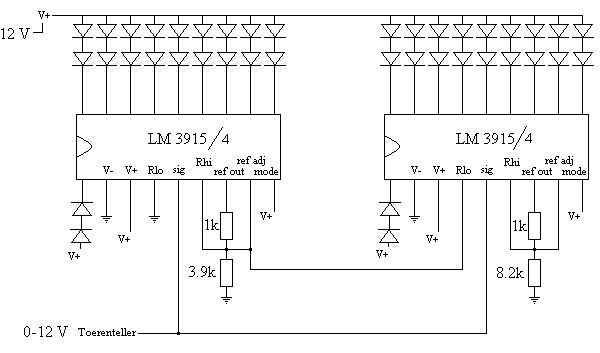

lm3915 circuit question
MrCarlos
Joined Jan 2, 2010
400
Hello zazas321
No, definitely is not the same as putting a resistance of 4.9K instead of two, one of 1K and another 3,9K.
These two resistors form a voltage divider.
With a single resistor how would you do ??
This voltage divider is to program the IC 'Telling'
what level of input voltage at PIN 5 turn ON the LED connected to PIN 1.
And
what level of input voltage at PIN 5 turn ON the LED connected to PIN 10.
It is to the measurement range.
Keep an eye to the attached PDF document.
