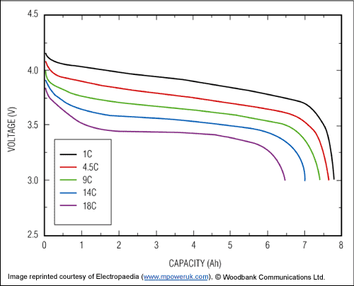

Because of the great current capacity, I'd lean towards the step up. Your voltage sag will stop the buck, before your current runs out in a boost.
ronv
Joined Nov 12, 2008
3,770
Lipos are pretty "stiff' until they go dead. With such large ones I don't think he needs to worry much about the voltage sag. His voltage should only sag a couple of millivolts at 1 amp.
