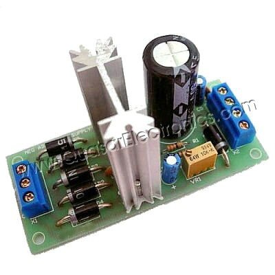

    Something like so:
    [​IMG]
    Input voltage: 1.2 - 37V AC or DC
    Output Current: 1.5A max.
    Voltage loss: 2.5V
    • Output reverse polarity and back-voltage protection
    • Output for LED power on indication
    • On board heatsink for IC regulator
    • Variable output voltage
    • AC or DC input voltage
    • Low noise (uses linear regulator)
    David
