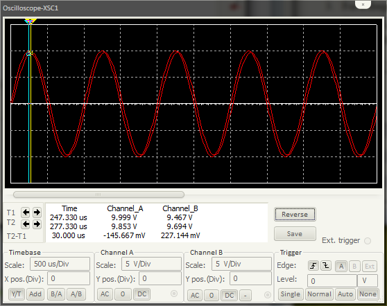

    So I've been trying to figure out what I'm doing wrong regarding a theoretical aspect of this lab. I've used both ideal analysis and experimental analysis and can't figure out if I'm doing this right.
    The circuit is shown produced in Multisim below:
    [​IMG]
    The function generator produces a sine wave of 10 Vp, 1 kHz, 0 V DC offset
    The corresponding OSCOPE window is shown below with the peak values indicated and the time delay given:
    [​IMG]

    So given:
    Z_L = 100
    V_S = 9.999 V
    V_L = 9.694 V
    dt = 30e-6 s
    ω = 2πf = 2 * pi * 1000

    An Xl of 19.33Ω would correspond to an inductance of 3.08mH. The exponential term is very sensitive to errors in Δt value. This makes the function highly dependent on Δt accuracy.

    783
    Paper analysis:
    line inductance L=3.3mH
    Hence
    XL=20.735Ω @ 1kHz
    Hence using voltage divider rule
    \frac{V_{load}}{V_s}=\frac{R_{load}}{R_{load}+R_{line}+jX_L}
    \frac{V_{load}}{V_s}=\frac{100}{101+j20.735}=0.96987\angle{-11.601^o}
    So with Vs=10V [angle 0°]
    V_{load}=9.6987\angle{-11.601^o} \ volts
    An angle difference of 11.601° corresponds to a time difference of 32.225 usec at a frequency of 1kHz.

    0
    Oh dear me... When performing XL=jwL... Forgot to make sure that w = 2*pi*f
    Thanks for the help. Last night I ignored what I thought of as errors and went on to complete the rest of this assignment... My values were correct to determine the power factor corrections for a resistive load and then an arbitrary load.
    I can't believe my mistake was that trivial!
