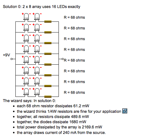

    So I revised my project so that it no longer includes confusing EL wire circuiting, but now I need help in a different area.
    I am wiring 10+ LEDs in parallel, all with 3.3v drop and 20mA current, to a circuit that is to be controlled by a photoresistor. The input is 9v. Now, the smallest resistance range photoresistor I can find is 16k-1M ohm, but I'm only going to need between 150 and 330 ohms of resistance for the LEDs. What can I use to bring the amps back up or decrease the resistance of the photoresistor so that my LEDs aren't barely lit?
    I'm a noob at this, so thanks!

    You need to use transistor to drive the leds and activate it by the signal of the photo resistor.

    The 9V you are using, is this a transformer, wall adapter...? What id the current output of the adapter? It will need to be at least 200mA as 10LED X 20ma each is 200mA.
    Try this resistance calculator out... Rrsistance Calculator

    Thanks for your help. I'll try to draw a diagram once I have the exact values for the components (I'll still need help figuring out how to wire the transistor and photoresistor). The power source I plan on using is a 9v DC wall adapter with 1500mA output, so I think I'm safe there.

    [​IMG]
    So if I buy a PNP Transistor with 350 mW dissipation, what range of photoresistor should I look for, how should I wire it, and how will it affect the rest of the circuit?

    A transistor will saturate with a collector to emitter voltage of about 0.6V if it has enough base current when its load is only 240mA. Then it dissipates 0.6V x 240mA= 144mW. Its base current should be the load current divided by 10.

    The only readily available photoresistors I have are unlabeled, so I'm going to have to measure the resistance or test them out. I just need to know how to wire the photoresistor and transistor into the diagram I posted above (and any other resistors needed). Thanks for your informative replies, mik3, but the photoresistor diagram on that page uses an IC chip instead of a transistor.

    Since I don't know if you want the LED's to light with increasing darkness or increasing lightness I'll give you one that does both!

    I want the LEDs to increase in brightness when the photoresistor is hit with more light (light activated, I guess).
    I'm assuming the potentiometer and LDR int he diagram are representative of 1 photoresistor? So then I just need to figure out the resistance range of the photoresistor and adjust my LED resistors accordingly?
    Also, would one lead of the photoresistor be connected to the base of one NPN, and the other lead connected to the negative lead of the power source? I understand how to wire the LEDs, resistors, and transistors, just not the photoresistor.

    If you want the brightness of the leds to vary with light intensity its better to build a simple current source with a transistor and few resistors. By varying the voltage on the base you adjust the current flowing in the collector and thus the leds current. Take care not to exceed the leds maximum current rating.
