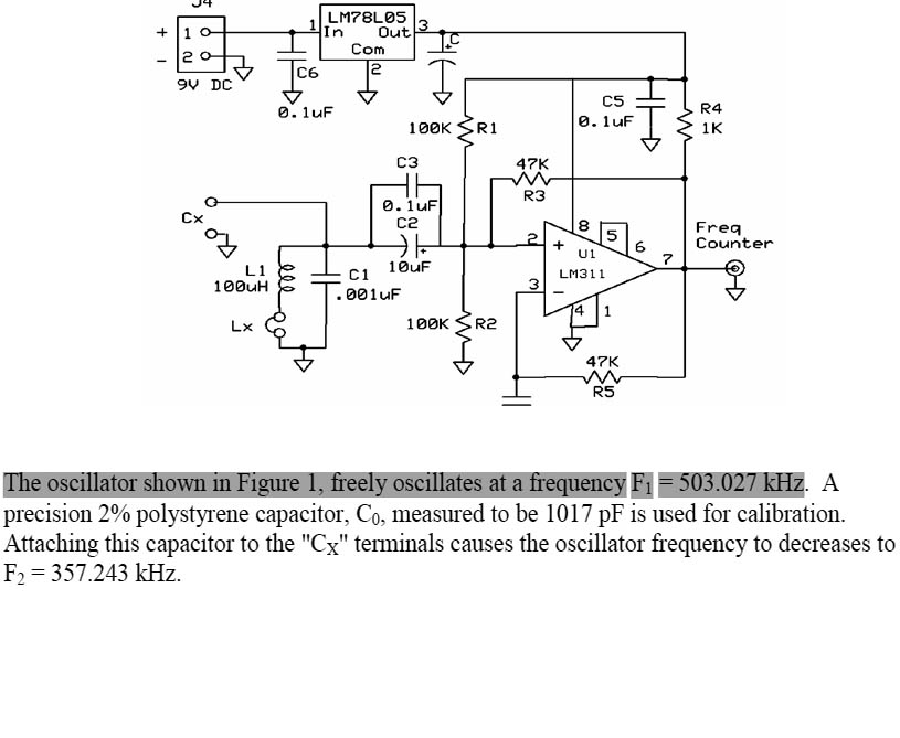

Do you have any links for that LC meterI create this circuits but my freely oscillates frequency not 503.027 kHz
my freely oscillates frequency is 357.888 KHz
i dont know why?
i uploaded a pdf i used for lc meterDo you have any links for that LC meter
