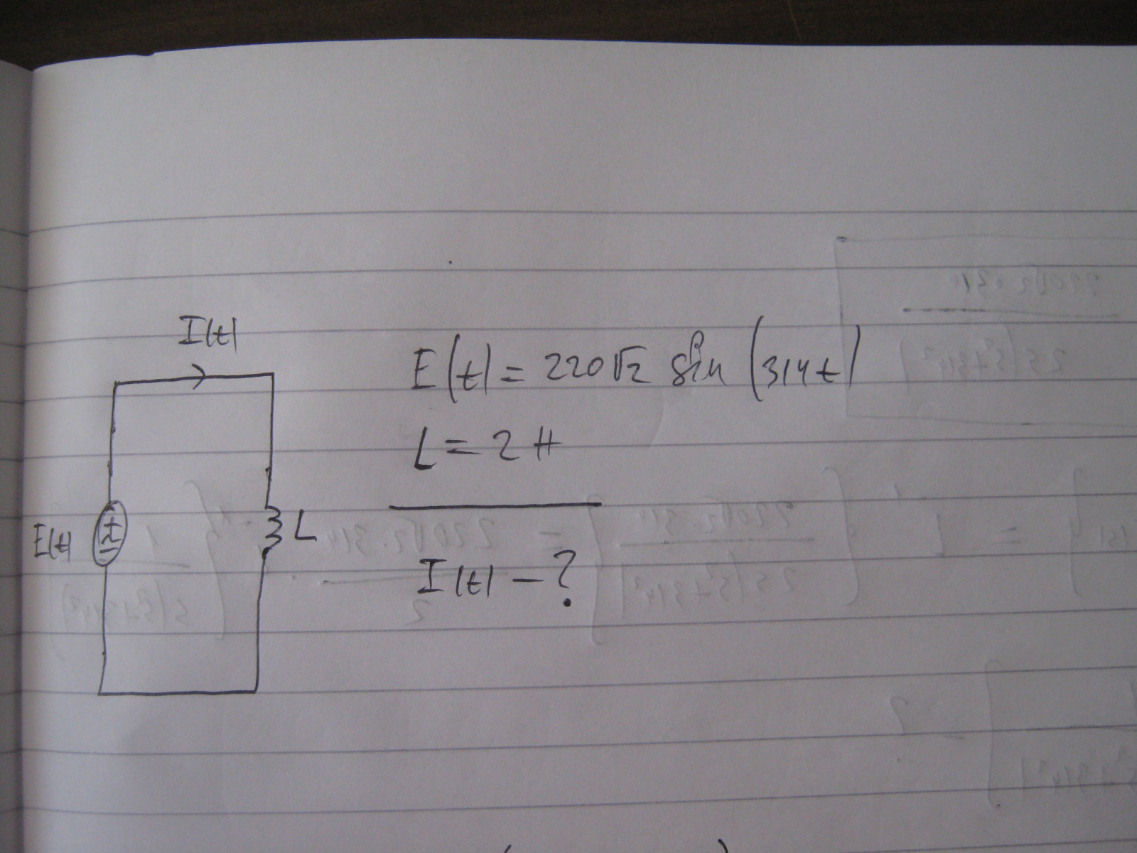

My task is to solve circuit below using Laplace transform:

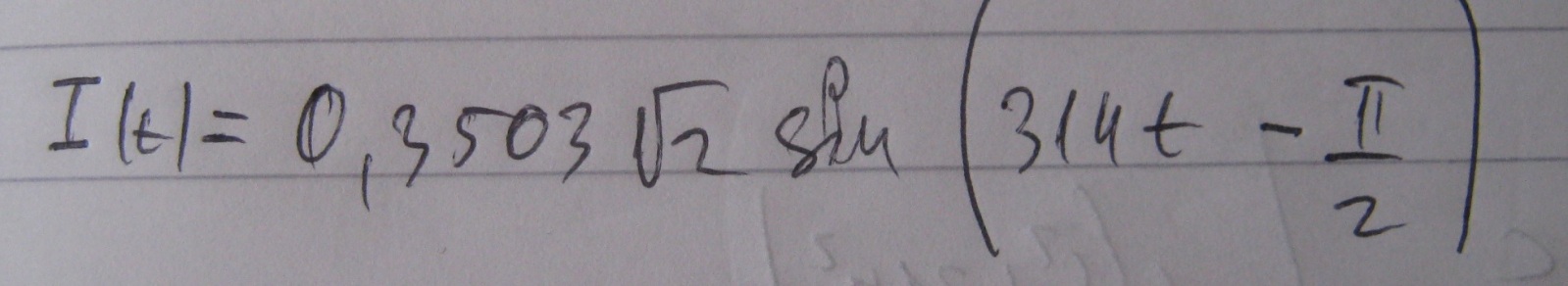

Firstly, I solved it using complex numbers and I got:

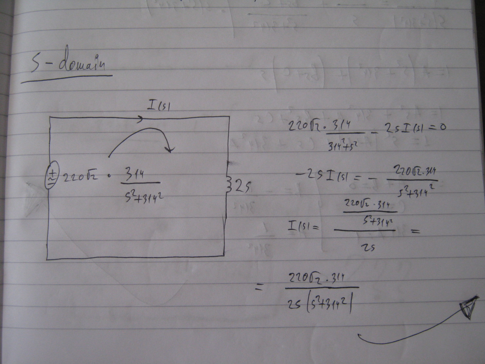

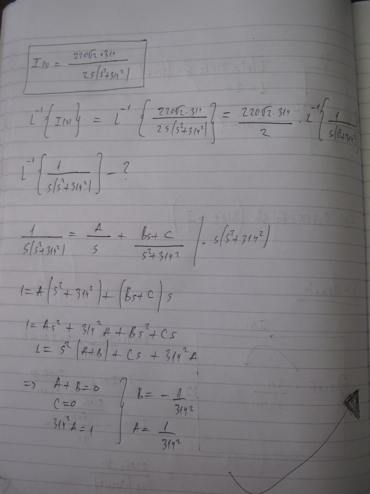

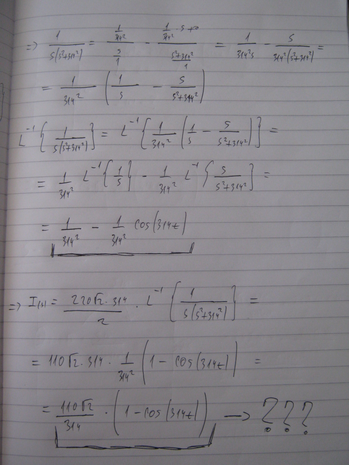

I'm sure it's correct. Here is my solution using Laplace transform:
It's obvious that solutions I got using complex numbers and Laplace transform are different. Where did I make mistake?

My first guess would be that you aren't using the same driving function in both cases. Hint: The transform you used is the single-sided Laplace transform.

But a single-sided transform means that the function being transfomed is taken to be identically zero for all time t<0. But the steady state analysis you did first assumes that the sinusoidal voltage is, always has been, and always will be sinusoidal.
Do you expect a circuit that has been running in sinusoidal steady state to have the same response for t>0 as the same circuit that has a sinusoidal source suddenly turned on at t=0?

I would expect it to.
But you answer has more than one problem. Notice that it is always positive. Does that make sense?
