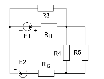

I got this
and i need to do formulas for
I Kirchhoff's law:
II Kirchhoff's law:
Circuit I:
II circuit:
i know it's very easy, but im just a beginner, so need a lot of help :/
Thanks in advance

Let's start with a little correction to terminology.
Circuit I:
II circuit:
You have one circuit, which is the whole diagram you have posted.
This circuit has several loops. Can you identify all of them? I make it five loops.
Kirchoffs voltage law (often called KVL) is written for a particular loop so you can write up to 5 different KVL equations.
You need to number the loops in some way to be able to identify them and refer to them.

What makes you think it's two circuits?
You have a single circuit with two energy sources. If your analysis does not agree with the conversation of energy and charge, then it's a trip back to the drawing board.

I'm trying to use google translator for some of the phrases, because no idea how to translate them myself, so that might be the problem... i think i need to make formulas for 2 of the loops.. my friend made me this picture to help http://i.imgur.com/fbtvbth.png unforthunalety hes not online anymore to help me further...
these are the 3 example formulas (NOT FOR MY CIRCUIT JUST AN EXAMPLE OF WHAT I NEED FOR MINE)
-I1+I2+I3=0
I1*(Ri1+R1)+I3*R3=E1
I1*(Ri1+R1)+I2*(Ri2+R2+R4)=E1+E2

You have a three dimensional linear vector space in three unkonwns. Because the circuit's linear, it agrees with the math (mostly).
One can be given an x amount of linear resistances with an x amount of succesive power sources, so don't be daunted by any given circuit.
Why can you construct a square linear system out of this mess?
I make it six.

Thank you for that correct, WBahn, I missed the one round the outside.
There are indeed six.
