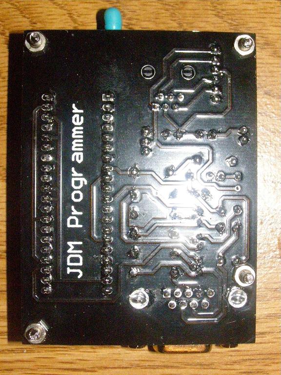

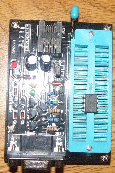

    Thanks for the info. I will admit that I'm pretty new to the electrical aspect of this so it's hard for me to decipher schematics. I can do the hands on work no problem though. Would you be able to take a look at the pictures of the programmer here and here. I'm hoping the front will be clear enough to see the traces. :rolleyes: I'd like to try to salvage this programmer if I could. Ironically I passed up that same programmer you posted because I thought it might not be able to handle the chips I wanted to program and also because it wasn't ZIF. :p

  7. hgmjr
    Moderator
    Jan 28, 2005
    9,030
    214
    The board you have appears to be a bit different from the one that is contained in the website that I linked you to. They are very similar in design but your board seems to have a few more bells and whistles on it. For example your board has what appears to be a couple of LEDs on it. The schematic in the link I sent you has no LEDs on it. Your board has the 6-pin header so that you can use it to program PICs in-circuit.

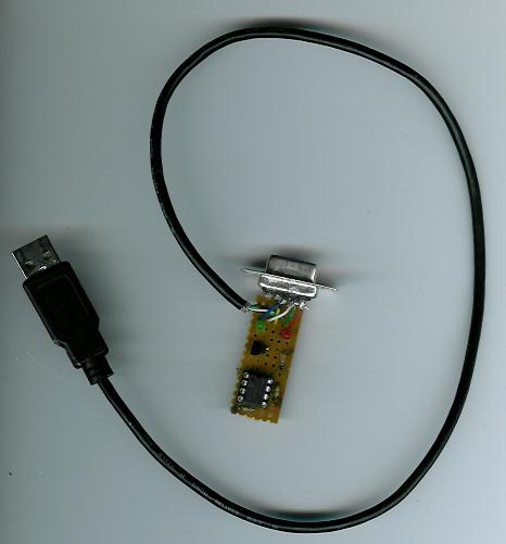

    Yeah I've tried WinPic, WinPic800 (not sure what the difference is), PicProg4U, and some other rare programming software that I found during searching in addition to ICProg and I get write errors with them all (the ones that supported JDM at least).
    I'll probably end up getting a transistor and resistor I need from Radio Shack and build this since it can handle 12f629/75s and at least with the USB power I will know that there isn't a problem programming because of a lack of enough power to the chip. If I ever venture out of 8pin land then the JDM programmer I got may work with them but if not I'll have a good reason to get a nicer programmer. :)

    Sorry for the bump but thought I'd give an update. Just got done building my JDM and programmed a 12F629 no problem. :D
