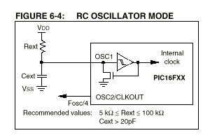

    if it was a crystal problem check the info below
    [​IMG]
    but if it was ok check that the port or pins you used isn't conflict with other modules in the chip like PORTA is conflict with Analog to digital converter module so you must 1st tell the controller that you want PORTA to work as a Digital i/o not ADC and that step is before the TRIS

    As far as the config setting goes, I'm using MPLAB as my native programming environment. Using it as the text editor and the compiler, as well as using the internal MPSim to check the code is viable. The settings for config are all set in a drop-down menu inside MPLAB and compiled into the code as necessary. As far as the oscillator goes, I'm running both chips in RC (resistor/capacitor) mode. Which, if I'm not mistaken from the datasheet I'm reading, is in fact an internal oscillator of marginal accuracy. I understand that the flashing of the led would be far faster than my eye could detect, but one would think it would give the illusion of being on all the time in this condition. On a whim I tried rewriting both sets of code to turn the led on, and not turn it off. (I removed the section of code rewriting PORTB to 0x00) This was my way of trying to see if it was the speed of the flash causing me some type of optical illusion. The ADCON1 was actually being written 0x07 in a newer version of this file. (sorry, should have posted that one...) If my code is far from functional why does it run in three separate simulation environments without issue? Just curious. I might try seeing about using a different form of oscillator though. I'll have to buy a crystal/oscillator...

    Like I said before neither the 16F873 or ancient 16F57 have internal RC oscillators. you can use a simple RC clock on them. A PIC can run millions of instructions per second. You need a delay.

    I was wondering if this was the case. I have to provide some external hardware for the RC oscillator to function. This does in fact make sense, and if I have the appropriately sized capacitors and resistors in my possession I'm going to give it a try. Have you seen a schematic for using the 555 to run the osc on a PIC? I've been looking with less than stellar results.
