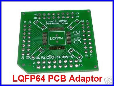

  16. ErnieM
    AAC Fanatic!
    Apr 24, 2011
    7,442
    1,628
    >it is SMD type, i need to upgrade my knowlegde and skill?? Yes, it is 2013, as an amateur like me, oh!?..
    With a small iron tip and a magnifier, thin solder and some solder wick anyone can solder tiny SMD parts.
    Adapter boards are essential to wire these. An adapter gets the close leads onto a 0.1" center which normal humans can handle. QUAD flatpacks have leads on all 4 sides and hence don't work in solderless breadboards. That's not an issue for anyone with a soldering iron and some wire.
    >will my debugger ICD2 be suitable for it? Any suggestion?
    Pick a PIC device, open MPLAB, and when you hit the menu for Configure | Select device you will see all the supported programmers & debuggers for that PIC. So pick a PIC your ICD works with.
    >I haven't any demonstration board for 18F and 16F in the past and usually assembling the trial boards on my own to do debugging.
    >what type of demo board shall i need to purchase for this IC?
    I am not aware of any demo boards, I'm sure they exist but I toss mine together myself.
    >I use MPLAB IDE v8.10 and PICCLITE and old version PIC18 complier, what types and version of softwares shall i need for it?
    I use MPLAB (non-X) and like it, I keep hearing about quirks in MPLAB-X.
    The C18 compiler is still a free download. You get 60 days free for the full version, after that it works but you get bigger code.
    >will this 16F1526 be a suitable choice or any suggestions?
    Selector guide says 55 I/O pins, best check that in the data sheet! If you're comfortable with PIC16 then stay with it, though I don't see much of a difference between PIC16 and 18 when working in C., except the PICs with more memory are PIC18's.
    BTW I keep a stock of adapters such as this on hand:
    [​IMG]
    Good thing I keep some around, as my favorite Chinese vendor (free shipping but takes 2 weeks) is closed till 2/15 for the Chinese New years. Some vendors from Thailand have PIC specific adapter boards with placed for decoupling caps and even the pins for a PICkit.
