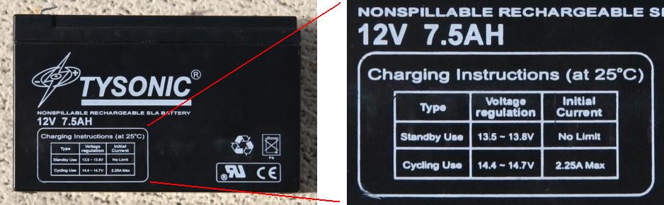

    I’m reading-up on rules and customs for charging lead-acid batteries. It appears that they have 2 charging regimes with different charging voltages: 2.30V to 2.35 V/cell and 2.40V to 2.45 V/cell (source: Table 4-5 here). That generally agrees with charging voltages imprinted on some of the batteries. For example:
    [​IMG]
    Notice that initial charging current for Standby Use (lower charging voltage) has no limit. Charging current for Cycling Use (higher charging voltage) has a limit at 0.3C Amps. Without the limit the battery would pull 2C amps at that charging voltage.
    Here’s what I’m struggling with:
    In the vehicles, the starting battery, the system load, alternator w/ regulator are all wired in parallel. AFAIK, there is no current limiting between the alternator and the battery.
    What’s the difference between these 2 charging regimes such that charging at lower voltage doesn’t have a current limit (or doesn’t need external current limiting)?
    Any suggestion, insight or reference is really appreciated!

    That's because a normal (healthy)"12V" lead acid battery float charged at that voltage level will draw VERY little current, that's why it can be float charged indefinitely that way with very little water loss over time.
    It might pull 2c briefly if it was SEVERELY discharged, but that's not normal usage for a lead acid cell. Even when using the 14.4V charge voltage (as Chrysler autos did for many decades) the battery comes back up to that voltage very rapidly after a significant discharge (like starter crank).
    Lead acid batteries have the characteristic that their voltage comes up quickly and then the current tapers off. They are extremely tolerant of charging systems built around the voltage levels shown on the label.
    FYI: I use a standby voltage of 13.2V on my float charger but it also has temp compensation.

    It took me time to wrap my head around it also, ~13.8 volts is the key, thats the voltage where the battery starts to gas and create heat. A good rule of thumb is you can charge a lead acid battery at any current you want until the battery reaches 13.8 volts, then you charge the battery using voltage and let the current tapper.
    IEI charging is a very popular charging method for lead acid batteries. What you want to avoid is heat and gassing. I found through experimenting that a battery will take in almost as much current as it can put out, so if you have a low internal resistance battery high current is appropriate.
    I - constant current until it reaches 13.8 volts (2.3 volts per cell)
    E - charge at 14.8 volts until current stops dropping (2.466 volts per cell)
    I - constant current of 2 amps until voltage stops rising (for automotive size battery, this is used to balance the cells)

    I would agree that severe discharge is a not common for starting batteries. Deep cycle batteries, on the other hand, are recharged after a deep discharge on a regular basis. So, a deep cycle battery can pull 2C for not an insignificant amount of time (seen that myself).
    40Ah battery cranking for 10 seconds at 300A discharges only 2%. I would agree that a slightly discharged battery would pull less than 0.3C. The battery is almost fully charged, so the charge current is not the initial charge current. Probably, this is why the primitive charging circuit in cars doesn’t age the battery too quickly. I’ve checked charging voltages in 2000s cars. 14.5V in BMW, 14.6V in Subaru.
    That's a useful curve. Where did you find it? I’m looking for in-depth references on lead-acid batteries.
    Manufacturers of deep cycle batteries almost always prescribe the initial charge current of no more than 0.3C. I haven’t seen data which would show how much and how quickly a battery would degrade if 0.3C is exceeded. On the other hand, several web pages say that lead-acids can tolerate abuse, but I haven’t yet seen quantitative data for that.
    My main interest is in deep cycle batteries.
