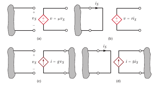

I would like to know the name or an explanation to what the colored "grey" objects in these example circuits mean. This picture was taken directly out from a textbook that used it for references of dependent sources.

They merely represent the rest of the circuit that has to be there, but is unimportant to the behavior of the controlled source.

Blobs?
Perhaps "black box"?
Or maybe "arbitrary circuit cloud"?
They are not defined. The whole point of them being there is to indicate something that you don't need to know about in order to understand what IS there.
