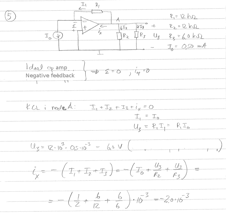

I really don't understand at all why \(U_3=R_1 \times I_1\). Isn't I1 divided over the two resistances? Thanks in advance!

If the op-amp is ideal, no current flows into or out of the -ve input terminal and the current I1 is set by the ideal source. So I1 must be Io. Again for an ideal amplifier the -ve input terminal will be at virtual ground because the +ve input is grounded. So one end of R1 is at virtual ground and the other end [Node A] is at a potential of Io*R1 or 6V. From there it's easy to deduce the remaining unknown currents, including ix, since KCL must hold true at Node A.

The non-inverting input is at zero volts, therefore, by definition of an ideal op-amp, the inverting input must be at zero volts.
Whatever current Io supplies must be nulled by the op-amp throgh R1. E=IR.

It seems that with ground at both ends of I0 it is a no-op, I0=0. The real ground end of I0 has to return to a negative voltage to get any current flow from the source.
Considering the given data: I0=I1=.5mA, Vout=I1(R1)=6V, currents in R2, R3 can be found using the current divider rule.

Io is an imaginary ideal current source. If you can imagine it has infinite impedance, you can imagine it has a battery and a resistor in it.
I'm not sure exactly what the issue is here ...
An ideal current source of value Io will notionally drive that same current into any resistance. If the source is driving a zero resistance load [a short circuit] then the source terminal voltage would be zero. So it is possible in the OP's schematic to have the source Io with the same potential at either terminal whilst delivering current Io. In the case of the active end of the source the potential is virtual ground rather than a direct connection physical ground.

Op amps that approach the ideal do exist in practice, while ideal current sources do not exist in practice. My warning is meant to inform the newbie that you can't build this circuit. Guess I should have said that.

I don't think your warning will help the OP understand the operation of the circuit, and I don't think it is right anyway.
This is wrong. There are many physical processes that can generate a current into a short circuit. The first thing that came to mind was a photodiode, the fourth hit on google gives some data: http://sales.hamamatsu.com/assets/applications/SSD/photodiode_technical_information.pdf
Look at Fig 2.2, this does approximate an ideal current source at V=0, Fig 2.3(a) shows you can control the current by varying the illumination, and Fig 2.4(b) shows this exact circuit used to measure the short circuit current of the photodiode and convert it into a voltage.
