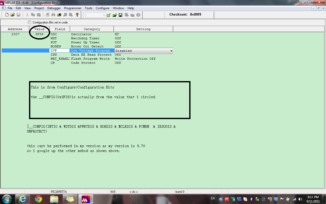

Could you also tell us what this magical number is
Rich (BB code):
__CONFIG(0x3F39);
I have no idea at all, and I have no plans to download the 16f877 datasheet to find out. If you had written in this style
Rich (BB code):
__CONFIG(INTIO & WDTDIS &PWRTDIS & BORDIS & MCLRDIS & FCMEN  & IESODIS & UNPROTECT);//NOTE ver 9.80 style
I would in a second spotted if it was something wrong in respect to your setup. I am in fact puzzled by the fact. That you are quite stubborn. You ask for help. But seems to follow the advice only if it suits you.

Ya,I have created the project file.
the __CONFIG(0x3F39) is actually from here:
http://1.bp.blogspot.com/-RgoUeac409s/Tmyprg1gaRI/AAAAAAAAAHM/_nqzwC_v2tc/s1600/Untitled.png

I have looked at your __config word. Now as it is not magic number. And as far as I can see it looks OK. So the next question how do you program your PIC. Do you do it via MPLAB or are you using the PICKIT 2 app? Do you get any error messages during programming. And are you also able to verify that the code in your chip. Is what you think you have programmed. Also try to erase your PIC and then do a blank check. Then reprogram it. Since you use an external power. Do not turn on "VDD" from PICKIT 2/MPLAB. Also if not done select MRCLR off.

Ok so you can burn and run the code(inside the pic) that you posted in your last post. I have noted you have changed the __config() value from x3F39 to 0x3F3A what is it in this change. What does the magic number 0x3F3A mean?

the 3F3A is explained here:
http://1.bp.blogspot.com/-C605a0NI3rQ/Tm2COduFZQI/AAAAAAAAAHU/gOQ3v7H2nlc/s1600/Untitled.png
sorry i dont know that but now i know how to use code tag.thanks!i will try the for loop u suggested.
