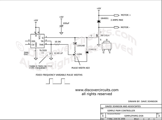

  12. ahmedahmedahmed
    Thread Starter Member
    Nov 12, 2007
    29
    0
    there is an attachment picture showing the PWM circuit digram
    thanks alot

  14. Voltboy
    Active Member
    Jan 10, 2007
    197
    0
    use a IR reciever that changes a digital potentiometer for the PWM.[​IMG]
    Just instead of the 500k pot use a digital pot that is changed by the IR reciever.
  15. ahmedahmedahmed
    Nov 12, 2007
    29
    0
    i put my PWM circuit. And i need to control dc motor using IR to that circuit.
    what can i do for that???
    please help me
    can i control my dc motor using LM324 IC and IR or not??? i mean my circuit???
    help me thingmaker3 please!!!!!!!!!!!!!!
    thanks alot
