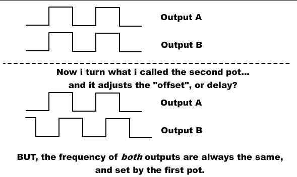

Ok, i have been looking for a soultion for a PWM i need, but it eludes me :(
I want a 555/556 PWM with 50% duty cycle. With 2 outputs:
First output will have frequency controlled via pot.
Second output will have the EXACT same output as first, BUT with a second pot create a delay in the wave form of the second output.
And if the first output frequency is increased, the secondary output will increase as well, but maintain the same delay ratio set by the second pot. Kind of like a offset...
Yes i know..."why not just use 2 PWMs". The project calls for strict offset prams, so i think 556 would be the best choice.
Thank you for your help in advance!

Should the 1st output always have a 50% duty cycle? If so, then it is a variable frequency clock, not a PWM circuit. If the duty cycle changes, then it is a PWM circuit.
You need to clarify this statement.
Do both the rising and falling edges need to be delayed, or just the leading edge, or just the trailing edge?
A diagram would be most helpful.

frequency, power supply, and load are not important. I have made many 555 projects before, i can figure out all that. I dont know how to make it have 2 outputs with the same frequency, and have output B with a offset or shift or delay...but still have the same frequency as output A
but if your really need those prams... 5v 1-50hz 50%duty

The second 555 segment in the 556 in my diagram is what you asked for, a variable phase shifter. By definition the frequency will be the same. Just use the same general resistor values and capacitance you have for the 1st one.
Just to be sure you know, a 555 drops 1.2V on the plus side due to it's output drivers. The output of a 555 with a 5V power supply (which is on the edge of their specs, which is no less than 4.5VDC) will be 3.8V max.
Load matters, because if it low you can use a CMOS 555/556, which doesn't have these problems. It is also a lot easier to design a 50% duty cycle circuit using one, as explained here...
