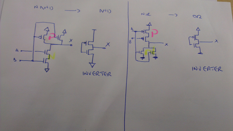

WBahn
Joined Mar 31, 2012
30,045
this is what you are looking for i think
How does a transistor implementation of a NAND and NOR help the OP implement the basic Boolean operations (AND, OR, NO) starting from the truth table of a 2-input Boolean function that is neither NAND or NOR?
