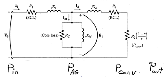

    I'm think this is the equivalent circuit model
    [​IMG]
    so would the line current be I1?
    Sorry, I'm still a bit lost

    OK - it's important to know which model you have.
    It's possible you may have been taught that the following relationships hold. For a poly-phase induction machine.
    Total Air Gap Power=p*I2^2*R2/s
    Total Rotor Copper Loss=p*I2^2*R2
    Total Shaft power=Total Air Gap Power- Total Rotor Copper Loss
    Hence Total Shaft Power=p*I2^2*(1-s)/s
    'p' is the number of phases & 's' is the slip.
    In this case p=3.
    You are asked to find the voltage that would run the machine at 1355 rpm - presumably with no mechanical load.
    The only mechanical load then that the motor 'sees' is 910W - due to windage and friction loss.
    This would be the total shaft power
    So
    910=3*I2^2*0.293(1-s)/s
    The slip will be s=1-1355/1500=0.0967
    This will therefore allow you to find the unknown I2.
    Once you have I2 it's relatively simple circuit theory to find I1 - which is indeed the AC line current. Hence you will also be able to find the input phase voltage V_\phi. You will have the voltage and current as complex phasors so you should then be able to deduce the input power factor knowing the phase displacement between the current I1 & voltage V_\phi.
    Efficiency can also be deduced by calculating the input power and doing the efficiency calculation with the shaft power as the result - in this case simply the windage & friction losses as the notional shaft mechanical output power.

  6. t_n_k
    AAC Fanatic!
    Mar 6, 2009
    5,448
    783
    Yes - You must include the magnetizing current to find the current I1.
    How did you arrive at 9.08A for I2?
    If the mechanical output is 910W
    then from the aforementioned formula (my post #4)
    I2=√(910/(3*0.293*0.9345))=10.525A

    How would I go about determining Im
  8. t_n_k
    AAC Fanatic!
    Mar 6, 2009
    5,448
    783
    E1=I1*(R2/s+jX2)
