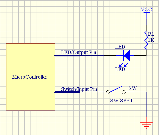

  11. HallMark
    Member
    Apr 3, 2011
    89
    5
    This is the Basic Schematic for the code i have written.
    [​IMG]

  12. t06afre
    AAC Fanatic!
    May 11, 2009
    5,939
    1,222
    That approach is kind of dodgy. An input should not/never be floated like this. Some MCU may let you enable internal weak pull-ups. But this must be set in code.
  13. HallMark
    Member
    Apr 3, 2011
    89
    5
    Oh sorry for this but the Controller i am using it provides internal Pull up and its Freescale so i forgot to put external Pull up.
    Freescale Controller not required External Pull Up. they are providing Internal Register to unable disable PULL UP.
  14. t06afre
    AAC Fanatic!
    May 11, 2009
    5,939
    1,222
    This mistake is quite common for beginners. With this setup you will most (very) likely not see any changes on the input port. If the MCU has internal pull-ups. You will never see any changes on the port
  15. HallMark
    Member
    Apr 3, 2011
    89
    5
    There is nothing wrong if we are using Freescale microcontroller but if you are using other than that then you must have to follow the circuit given by t06afre Sir.
    Thanks t06afre for correction. :)
  16. t06afre
    AAC Fanatic!
    May 11, 2009
    5,939
    1,222
    No my circuit are wrong. It should not be used:eek:
  17. HallMark
    Member
    Apr 3, 2011
    89
    5
    What happened Sir?:confused:
