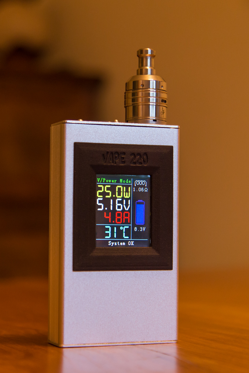

Looks nice. I wonder if you could make a variable temperature version, seems like it might be useful for that sort of thing. You could turn the power off for a few milliseconds every now and then and measure the resistance, if you have the resistance / temperature curve for the heating element you can work out how hot it is.
portreathbeach
Joined Mar 7, 2010
143
Yeah, that could be done, but all the heating coils that are used in these devices are home made. They are just a few wraps of kanthol heating wire. I suppose, you could take a cold reading and then when it's being fired, keep reading it and work out the temperature. Trouble is, as it's a coil, there would be inductance to think about too.
Markd77
Joined Sep 7, 2009
2,806
I just realised that I failed to spot the obvious. Because you are constantly measuring current and voltage, you already know the hot resistance. To get the cold resistance you just need to be able to make those measurements quickly before the coil heats up. I doubt that the inductance of a few coils of wire without a magnetic core would make any difference after a few microseconds. It could have the benefits of faster heat up time (can be run at full power until the coil is hot) and you could swap coils without the resistance change making a big difference.
THE_RB
Joined Feb 11, 2008
5,438
Why the need for a cold reading? Just measure the hot resistance (with current and voltage data) and use a lookup table to show what temperature it is at.
portreathbeach
Joined Mar 7, 2010
143
Hi,
I actually only read the cold resistance. I blip it for 50ms and take the current. It's not that critical really. Even after the coil has heated up, it's usually only about 0.1 ohms different anyway.
