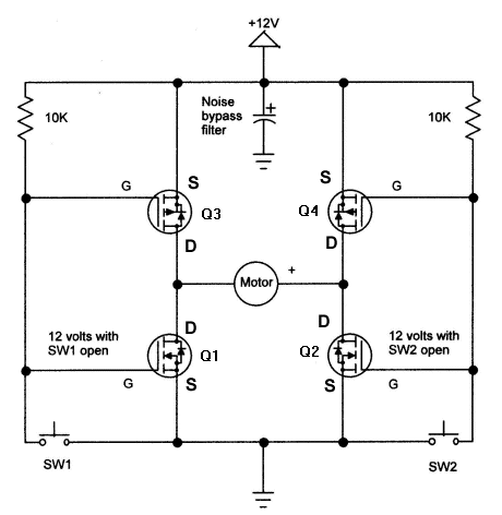

    Will max620 will be better than 7407??
  17. RRITESH KAKKAR
    Thread Starter Senior Member
    Jun 29, 2010
    2,831
    89
    Is this a right way to use....??[​IMG]
  18. Audioguru
    New Member
    Dec 20, 2007
    9,411
    896
    Now you show a schematic with a 12V supply to the Mosfets and two 12V "switches".
    What will you use as 12V switches that can be driven from the PIC?
    The Mosfets have a high gate-source capacitance and the high value of the 10k resistors will charge and discharge them too slowly for high speed PWM.
    RRITESH KAKKAR likes this.
  19. RRITESH KAKKAR
    Jun 29, 2010
    2,831
    89
    It was for testing purpose..
    You are right and now i am testing H-BRIDGES with this schematic....
    I am thinking to use any voltage amplifiers your opinion will be nice, now i want to use it for 24V supply ...
