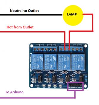

Right I mean, does it make any difference to have the neutral going to the relay like i wired it opposed to the hot going to the relay, which is what you suggested?
What I took from what you said is, the way I have it wired, if you stick a fork in the small hole you will get shocked because I have the hot going to the outlet. Vs if I had he hot to the relay, you could put a fork in the outlet and not get shocked.
Right, Right.
And if you install it and try to sell your house the inspector will make you fix it.

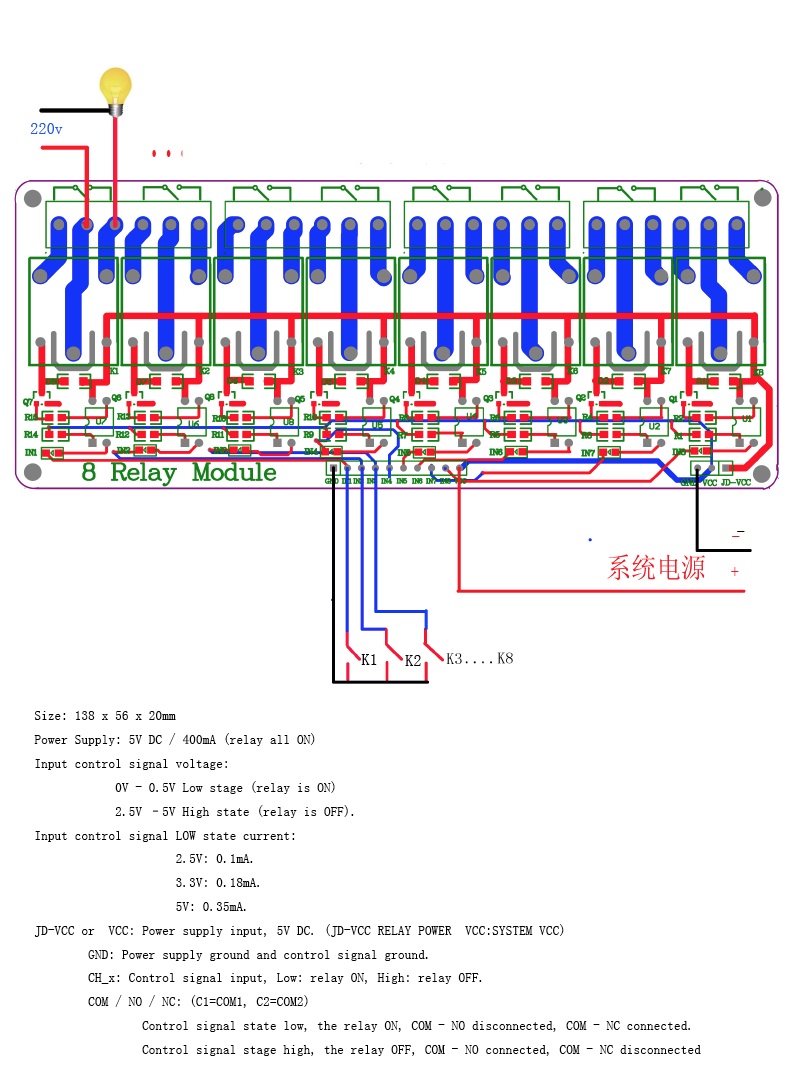

I know you said it was correct, or at least it would work, but just to double check, did i choose the right slots for the relay? i posted the diagram and each relay has 3 slots, "A" "B" "C" i put the neutral in "A" and "B" and nothing into "C"
you've been extremely awesome and patient with me ronv thank you so much for your time!!
I'm not sure. The schematic shows 1, 2, 3. and you would use 1 and 2.
Do you have a different picture?

In this picture they show it wired like you suggested. (it was actually a really good page i wish i would of found it earlier) in the comments one guys proposes a question that sounds like what i was asking was ok to do, switch the hot into the relay for neutral into the relay. Hope one of these is what you meant by different picture?

Not personally, I would need to take it to my friends to use meters. would it make any difference between going from the wall directly into slot 2 vs going directly into slot 1? or is it the same thing so long as you use those 2 per circuit? just curious.
ronv
Joined Nov 12, 2008
3,770
Same either way.
