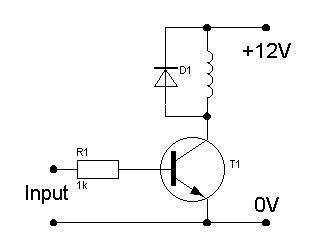

    I also searched for a solution to make TTL level logic turn on and off major loads.
    If you look at your data sheet you will prob see that Vce current is 500ma max or so. Try this circuit out. Buy a relay (shown below as a coil) that will support the current requirements of your solenoid. Use an ohm-meter. Divide 12volts by the resistance of your solenoids coil. Thats your current I=V/R. The diode in the circuit is REQUIRED! I know I've tried not using it. Not pretty.
    Robert
    [​IMG]
    R1 = 1kohm (try different values)
    Diode = 1n4001 (suggestion, many will work)
    Transistor = 2n2222 (again a suggestion)
    Relay 12v coil, capable of withstanding your current requirements.

    Robert's schematic should work for your circuit. For R1, you can increase it up to around 3k, but I suggest that you don't decrease it below 1k.
    Don't forget to use D1. Check the datasheet for your solenoid to make certain that it doesn't have one already built in. If it does, you will have to make certain that you connect the terminals properly.

    The solenoid will attempt to maintain current trough it (inductive). So while the transistor is conducting the solenoid stores energy which it uses to try to maintain the current constant when it changes.
    What happens then when the transistor stops conducting is that the solenoid will induce a big voltage spike accross it's terminals in attempt to keep the current flowing and this voltage spike could destroy the transistor.
    The diode mentioned will prevent this from happening. The diode is a must :)
