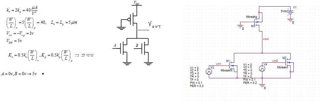

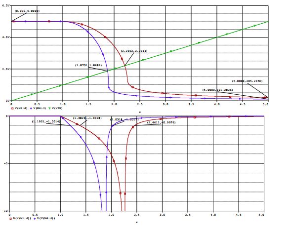

help building VTC of a circuit pscpice
Discussion in 'Electronics Resources' started by mosfat, Oct 9, 2014.
  1. mosfat
    Thread Starter New Member
    Dec 8, 2013
    4
    0
    i tried this circyit but ,i dont know how to get that graph
    thanks
