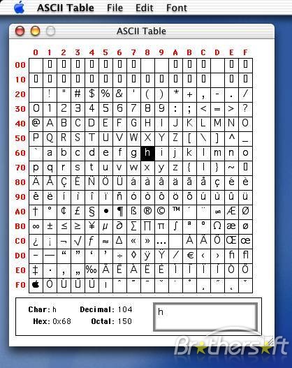

If you can send 16 different DTMF tones you can send the ASCII code as high and low nibble http://en.wikipedia.org/wiki/Nibble so to send a "A" , you send the nibbles 0001 and 0100. That will be same as pushing key "4" and key "1" However if we look at output from the DTMF chip you plan to use(picture). The output is somewhat rearranged so 0000 is the key "D" so in order to send the "P" you must push keys "6" and "D" I think you should start in this end. Then you get things working you may implement a lookup table. So then you push "0" the PIC will this as the nibble "0000" And key "A" will be interpreted as "1010"
