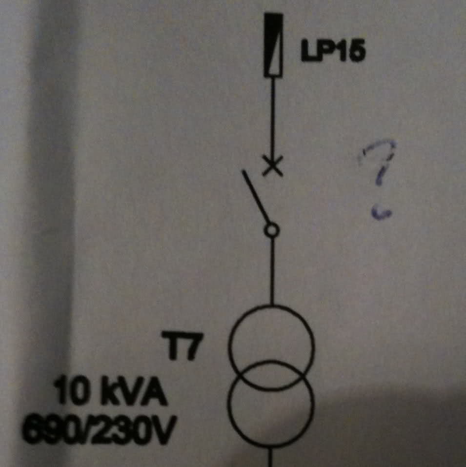

Hey all!
Im kinda stucked here with these symbols. Does anyone have any idea?
1. I think its a terminal, but Im not that sure, since it is connected to a circuit-breaker (which is connected to a transformator)
2. Just to clarify, is 250A the current rating of the circuit breaker?
3. What does this "M" stand for?
4. What does this "C" stand for?
5. What does this "12 of" stand for?
6. "EG" ?
Thanks a lot for all the help! ;)

250A is the current capacity.
M stands for Manual cutoff I presume
C could be cut out
I can't say anything abt "12 of" without seeing the whole diagram
EG could be a an AC Motor

Umm heres the circuit breaker with "4 of" is just connected to a bus. The same thing with the "28 of"
And any idea with the symbol 1? ><

The "4 of" 630A usually means that there are 4 630A breakers on that bus (and likely will show up on another diagram showing what they feed)
