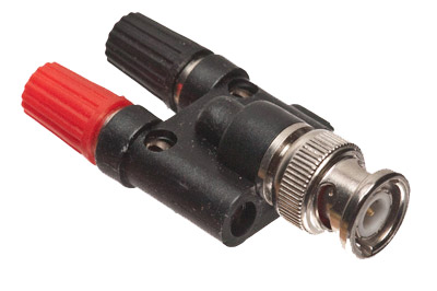

What test equipment do you have?
Do you have a DMM, working oscilloscope, function generator?
Do you have a coax cable with BNC plug on one end a two alligator clips on the other end?
or this
