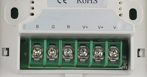

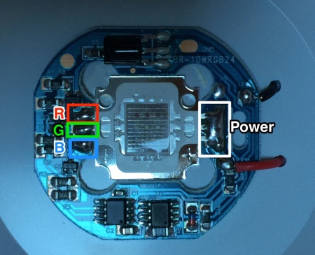

I bought an RBG light off e-bay which has an IR (Infra red controller) in the board and only 2 wires coming out (12V Power + & -)
Now I would like to connect that light to an RGB controller which has 4 outputs (Power, Red, Green and Blue)
After Opening the light this is what I found:
* please know that the diagram is my best guess.
So my question is this:
Can I just simply disconnect the "Negative Wire" and add the 3 separate RGB's like so:
Or should I disconnect the circuit board as it won't be needed?
Example of what I want to do:
